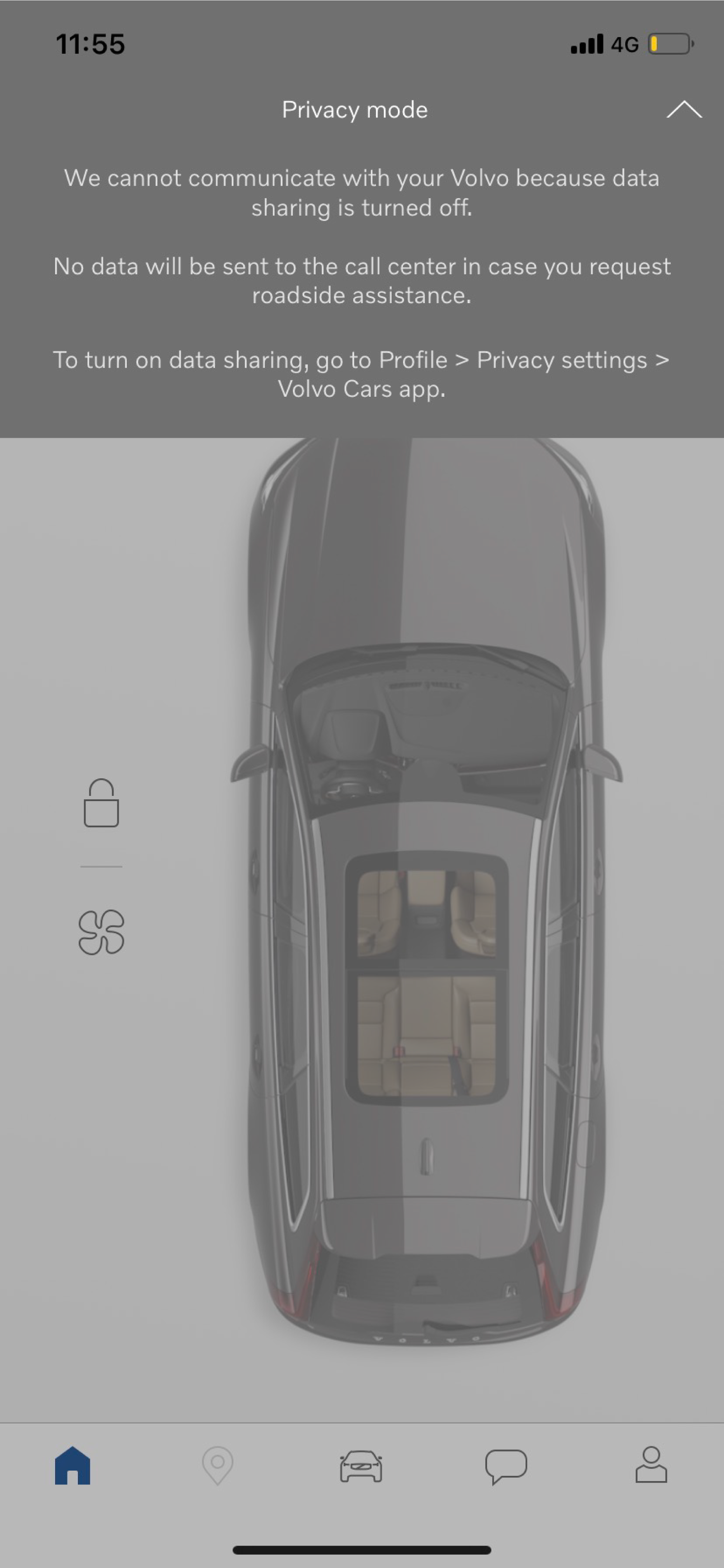

Enabling data sharing for the Volvo Cars app
Data sharing for the Volvo Cars app needs to be enabled in order for the app to access data from the vehicle. This is needed for functions such as climate and lock/unlock doors.
In the center display, go to iCup-2037-Settings symbol > Privacy > Volvo privacy settings > Volvo Cars app.
Make sure that data sharing is enabled.
23w23-Latest info-VC app privacy error message
Error message in the Volvo Cars app when data sharing is disabled.
